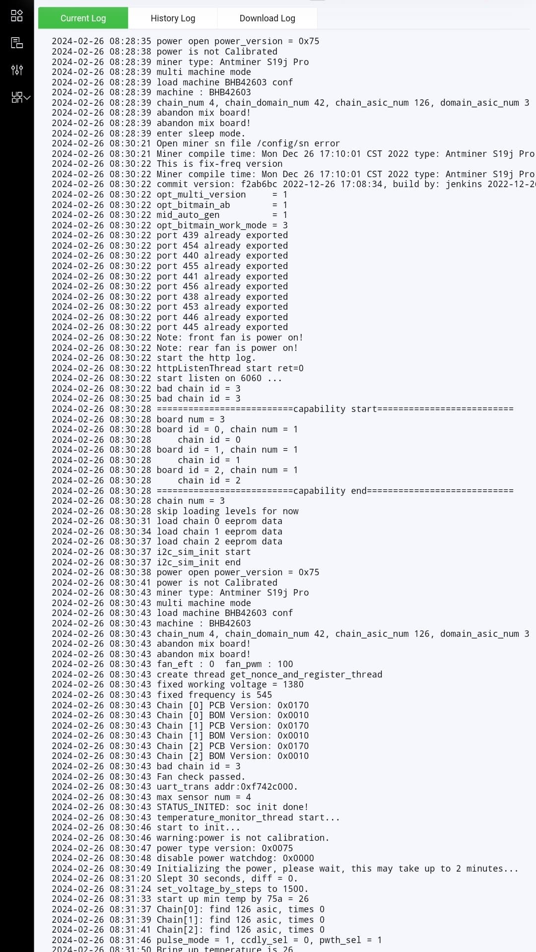

See how mine says power is Calibrated
Yes i see that.

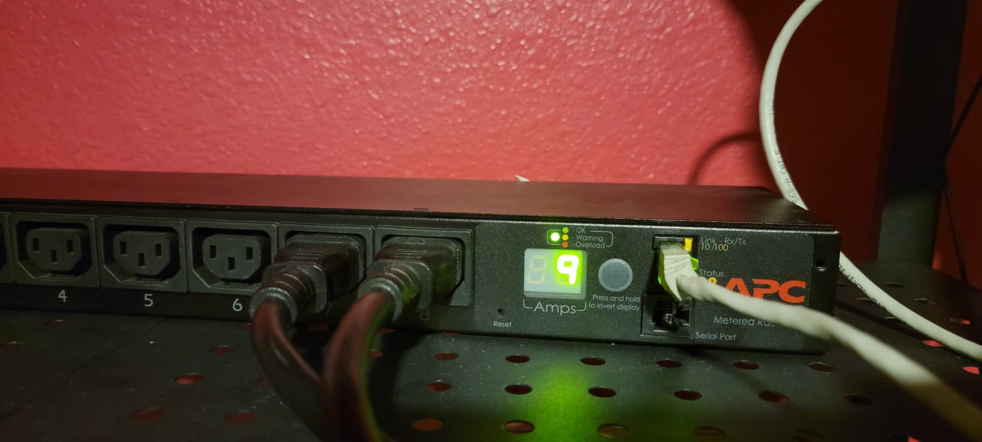

So was able to successfully log into the apc Search protector
In the logs just repeat itself over and over

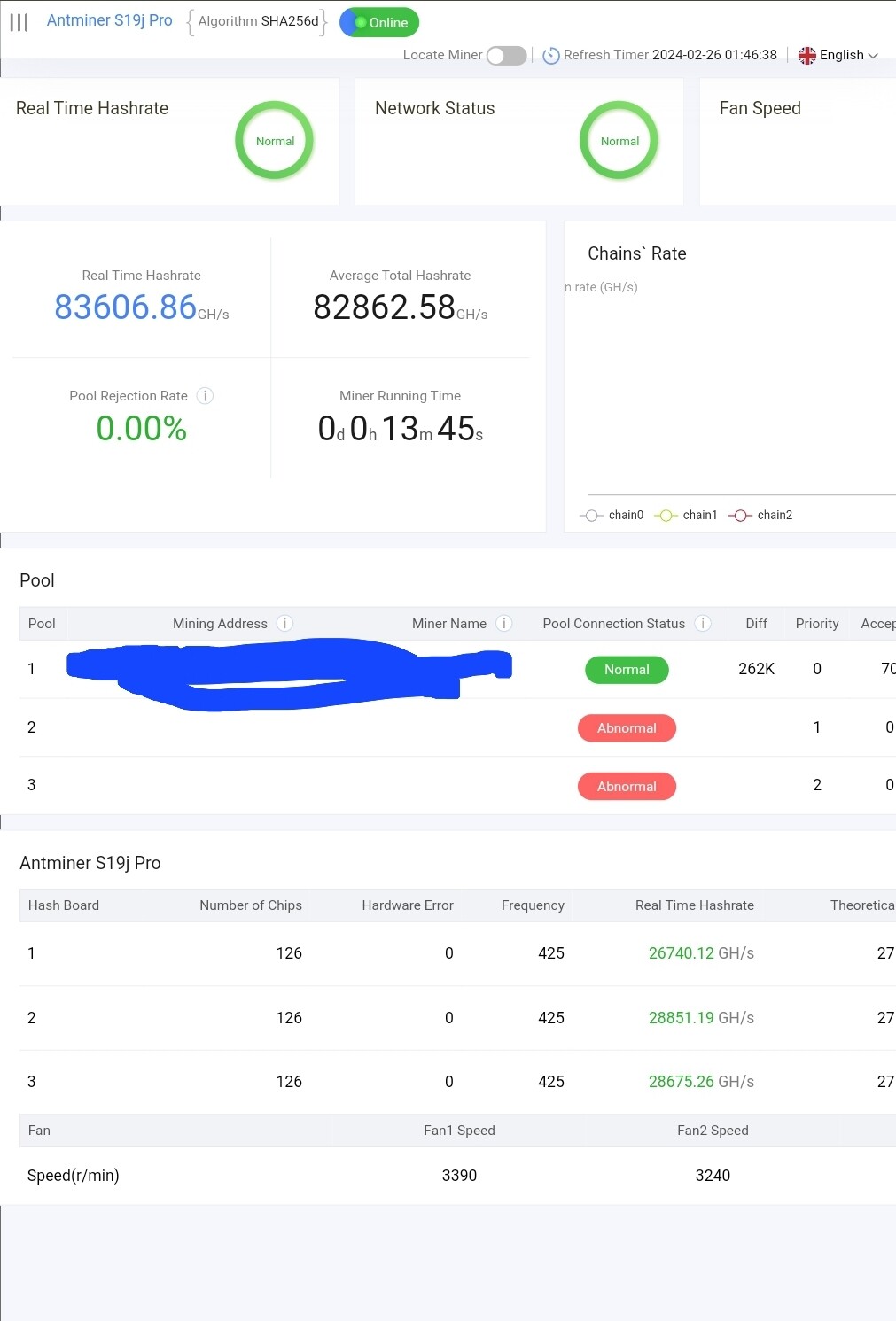

After leaving the S19j pro unplugs set 30 minutes or so. It seemed a fire right back up.
On low just as a test.
Yep so it’s slowly built up the frequency to the low power mode which is 425mhz and I can’t remember the voltage which is something like 13v off the top of my head. Will be interesting to see if its the PSU or your power outlet or your surge board

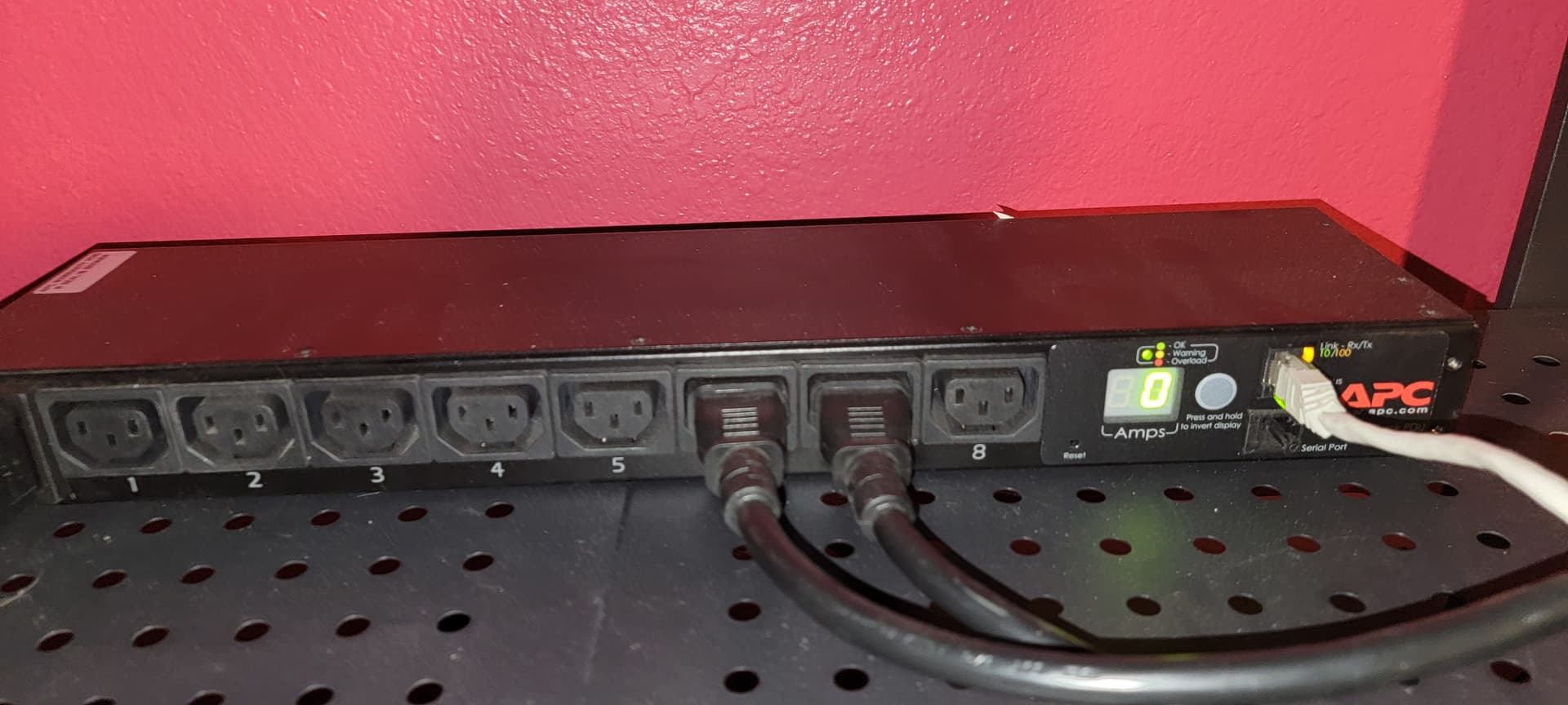

Well, after logging into the surge protector.
I realize the person I bought it from said It was a 30 amp surge protector But he lied it looks like it’s 15 amps purplug.
After logging into it, it says the max load, which would be in the danger red zone is 16 amps. I wonder since I normally run it on low Switching to normal mode is causing the miner to struggle on getting its adequate power. Because I never had a problem. Until I ran it on normal mode.
It ran decent for a few weeks until just the other day. But like I said, I’ve always run it on low until now.
