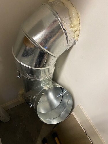

I had a few requests to share some photos of my mining cabinet. It is 90% complete. Now that the heat/exhaust issue is solved I can add some extra sound proofing material to knock down the noise and a little clean up on cords and cables. Hope this helps some of you out there. It is definitely worth having a plan on how you’re going to deal with the noise and the heat if you’re running these in your house.
I used 8" rigid ductwork (insulated) with a 8" Soler & Palau inline fan to draw out the air. 2 suction points in the cabinet, one in front of the ASIC’s and one at the top for residual heat. The hot air exhausts in to my garage over the winter with a damper to throw the air outside over the summer. I have an intake grille with filter on the opposite side of the exhaust. I built a channel inside the cabinet so the cool air that is drawn in blows directly across the miners. Currently running a CK5 and SJ19pro, 3 Mini Doges & 1 KD Box. Everything is running happy and cool inside. The cabinet is built from 2" foam home insulation

Looks a right botched up mess :rofl::rofl: A1 for effort :+1::+1::sweat_smile::sweat_smile:
Thanks for your feedback. I guess we’ll give you an A1 for effort in attempting to bring value to the forum
