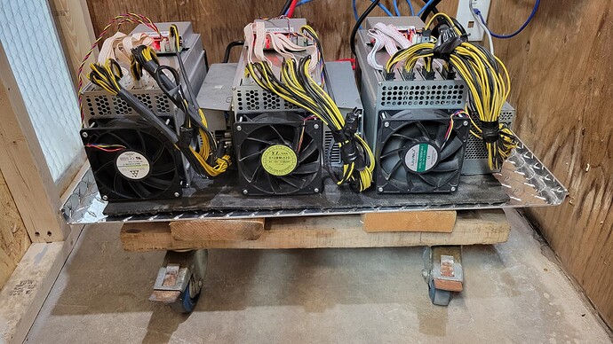

Well, its not 100% finished but it looks like this :
Ac infinity 800cfm exhaust fan shoots into my attic, plugged into a google nest thermostat so in winter when its cold, the fan starts just when needed.
I keep the door open currently so it keeps my garage warm and dry during winter, in summer the door will be closed and fan will probably run 100% of the time.
Spare electric outlets are already installed, just need some shelving for 1 or 2 more miners in there.
The L3’s are on a rolling platform i already had, so i can move them in/out the enclosure easily when needed.
I just tried the setup with the door closed tonight and i am able to keep this thing pretty cool with the fan running at about 75%, i could probably even go with the fan a bit lower at this time of the year.
So overall, its far from perfect but i am happy with this little setup!
