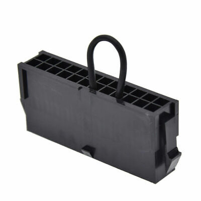

ATX PSUs are quiet, but you need to jumper the power switch pins to make it turn on. If you get one of those with support for 3 PCIe then the cables will come with it.
I use these:
