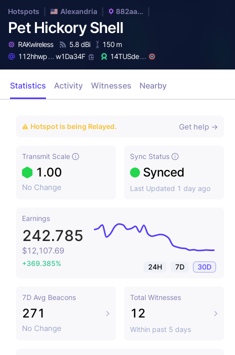

The HNT network is messed up in POC. They were trying to get rid of gamer’s that had devices inside the same house / company. If you put each on a different IP address and you spoof the location on setup, then each one appears in a different hexagon. However the HNT people are trying to use RSSI and SNR just like cell phone technology can ping your phone with in 25 feet after several pings from 3 towers. The HNT people are weeding out bad actors getting $4000 - $10000 a month on gaming setups.

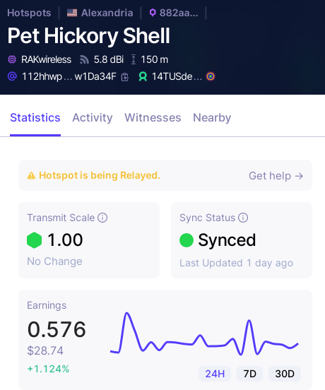

Even Pet Hickory is finally taking a hit in rewards but even that hotspot is in RELAYED which it really is not. Just reported that way for now until the HNT get it right/better on the real poeple trying to do right with the network setup.
This a 24 hour report.
Then you can see the 30 day before all this started a few days ago.
