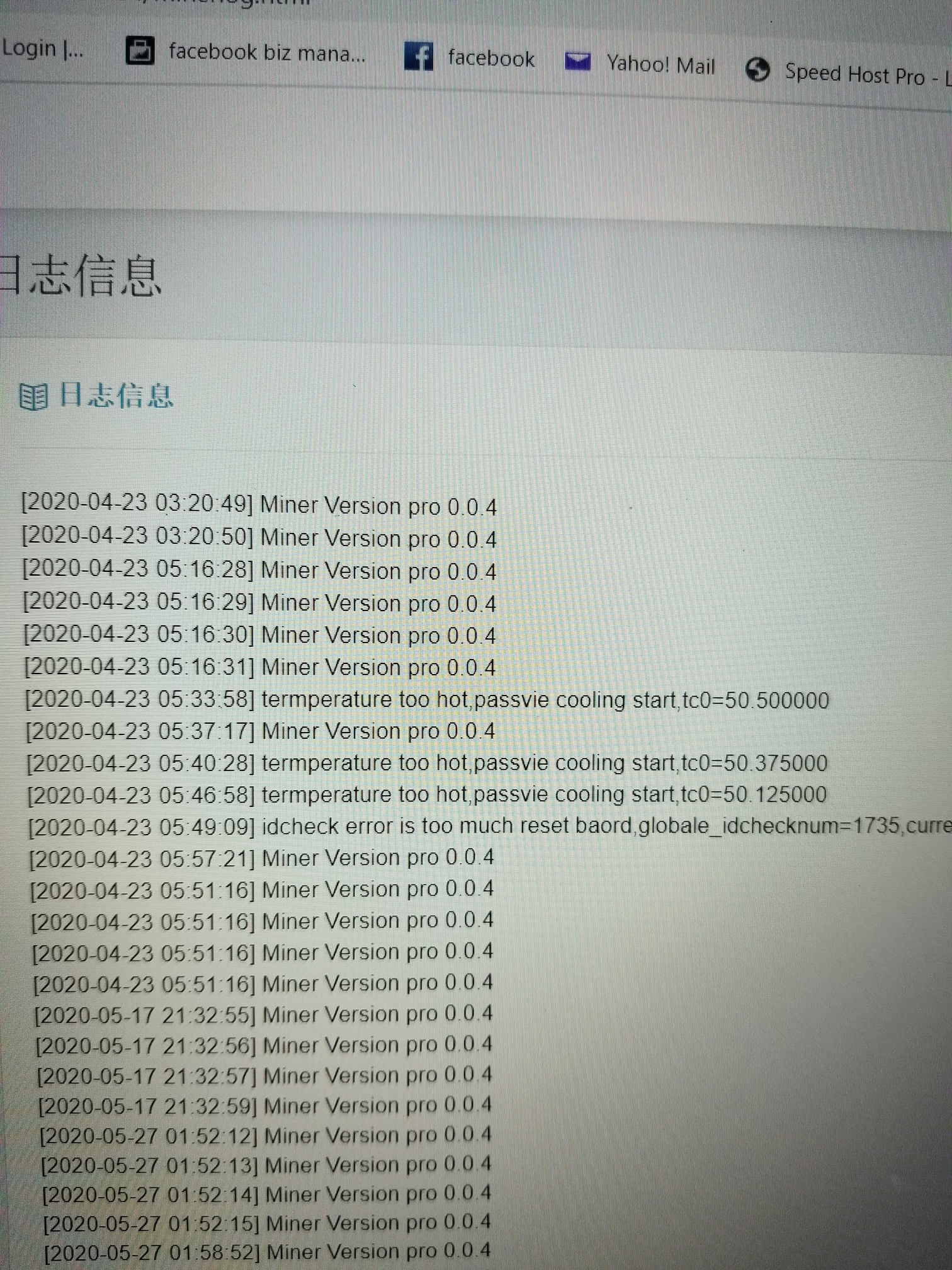

Been runnin for 2 hours now and still going…I noticed in the log information it shows it was overheating but they must have fixed it because the log straightened out. In the immersion no probs

Okay so last night the engineer pointed out 1 fan is not working so I just pulled out of tank…and sure enough my top fan on the power up side is out. Since fan is out it will not hash.Seller shipping new fan when H1’s come,gonna see if I can pay to ship tomorrow. For a thing that makes such a loud noise,it sure is touchy. Thanks for all yalls help, as it is much appreciated…on that note h1 is back at $100 day…stay up there till I run for 30 days,lmao
Ima nube meatymouse,but have learned alot since then…the c1 pro was actually free…I won alota money betten football,they paid me in bitcoin cash at $177 share,sold out at $255 so it don’t phase me… I ran it before I immersed,only problem was I didn’t know what I was doing. One fan cost me 3 weeks time…I didn’t notice it wasn’t spinning,the company I bought from had their engineer look at it,he saw the fan wasn’t working,during shipping the fan guard musta got smashed into the fan,when I took the fan off and tested it worked fine. I nvr make the same mistake twice. Mistakes cost me in life, so not complaining on my mishap. If I woulda kniw hiw hot that tank gets I woulda nvr spent 400+ on bitcool n tank,but machine worked in bitcool and stayed cool till I possibly swapped wrong wire harness. My friend was talkin to me and I was looking at him when I took first 2 harnesses out to get to the fan harness and then saw a port with no harness…2 harnesses out and 3 ports,uggg,which way did they goooooo,lol. 2 lessons learned their. 1 don’t take your eye off what u workin on and 2,no more bitcool if it stays this hot…hashing at 6400gps is way too much for 2900+gps machine…next time we b ready

Latest news,I was able to figure out how to get it hashing,machine is fine,problem gotta be that 1 radiator is not enough,runs at 45.5 degrees when hashing outside the tank,55.9 and rises in tank. But,the hashrate is low(2200) so I sent videos of the miners actions and reports. Engineer is going to go over Monday morning.
