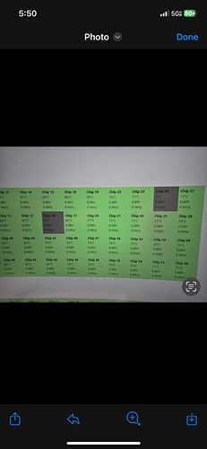

Okay so I decided NOT to send the miner all the way back to China on Icerivers “warranty” because after spending an 700 dollars to ship it back to Hong Kong and receiving the miner back in non-operational condition, my faith in Iceriver’s ability to repair their own miners was nonexistent. The amount of time and money it takes to send a miner back to Hong Kong absolutely irradicates the idea of ROI but especially when the miner doesnt come back working. After their failed repair, I asked if they would send me another miner and I would send them back their lemon miner. They declined this request. They kept insisting that they fixed the KS3M and that I would need to send it back in again at my own cost. I will be asking for any other form of compensation but I wont hold my breath. Ill let you guys know how that goes. Ill let you know what I am taking from this valuable lesson. DONT BUY ICERIVER BECAUSE THEY ARENT EQUIPPED TO TAKE CARE OF THE US BASED CUSTOMERS. Stick with Bitmain, because there are about a dozen shops around the US approved for Bitmain warranties. Yes they are a little more expensive but better that than miss out on months of mining because of Icreiver’s lack of customer service and expensive shipping when your warranty work isnt going to get completed.
Customer service started to blame it on “environmental” issues. I explained to them that this was at a farm and hooked this rig up to the exact spot that my other KS3M that was hashing was so it couldn’t be due to the environment. Here are the pictures of the dead chips that was sent to me by the US based repair shop. (This was after Iceriver had sent me the miner back from the warranty repair.) It never hashed at all once received.
Sucks but I’m glad you sent it off to a local repair shop. Out of curiosity, who did you send it to?
Yeah its been a rough go with Iceriver. I ended up going with a seller on ebay that Mr Mike sent me. I tried finding someone on Zeus but most of the repair shops on there only advertise for Antminer repair. Icerivers are just too new. It was 640 dollars to repair 2 chips on the hashboard. He also said that he was going to solve the overheating problem on one of the boards above. I haven’t got to start the miner up yet because I have to wait until the first of the month for the farm to start it up but we’ll see how good of a job he did. Crazy quick turn around though.

This is the exact guy I used. He initially charges like 450 after tax or something like that, and then if you have dead chips he is charging like 100 bucks a chip. It ended up costing me 650 total.
I just started it up today though and its hashing like a dream.
Sounds fair, but same amount as the refurbished once from iceriver themselves. Was that price per board? I have 2 bad ones.
If you have bad boards that will be different. It was 100 dollars per bad chip. So depending on how many chips are bad it could get costly.
