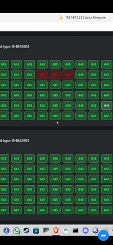

Well there you go. Trying 80T at 20 watts/T turned 3 of my chips permanently bad. At least I have the means to fix it if/when they die.
Edit: It now says those chips are functioning correctly
