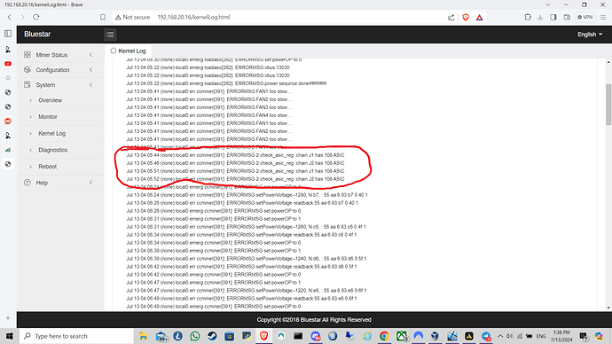

Also confirm what number of chips the hashboards have which will show in the log. Mine is 108 chips. So if it’s the same measurements and number of chips it should work.

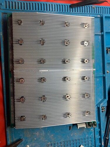

I’m going to take pictures of my board with model etc. so you can confirm if it’s what you’re looking for
Well I was wrong it actually does run with only 2 hashboards if the third hashboard is still in place but the ribbon disconnected from the control board.
Pictures below you can see it finding 2 boards of 108 chips, one pic is running low power mode and the other one is running normal mode all with 2 boards
So it might be possible for you to butcher a miner, find 3 working hashboards and have one running properly. You will just have to read the kernel log to figure out which boards are which. On the control board next to the ribbon cable plugs to the hashboard it should say J0, J1 and J2 I think, match that up to your miner kernel log and see if any of your boards are running the right amount of chips and put them in one hashboard together.

My boards are 200mm X 245mm
The board models look like it is L0010_B
As long as your boards are the same size and chip count it should work. If you need any help or want mine let me know
Yeah bro, I am able to access the kernel log on both miners. One of the miners works, but only in low power mode. The other one doesn’t work at all. It sounds like the hashboards you have could fit in the Hammer D10; mine is also 108.
