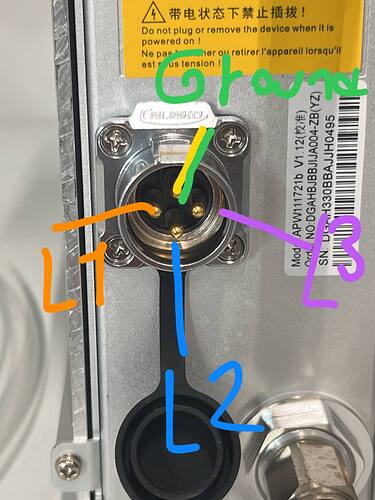

Hydrominer cable, how to wire!
Correct right?
No 0/N (neutral) connected?
Pretty sure you need this mate! Antminer Hydro PSU cable | Zeus Mining
As always @ShredZ thank u, i got the cable already but was asking how to wire the other cable end, but they are L1, L2 and L3 as u drawed :slight_smile:
It’s perfectly working already-
