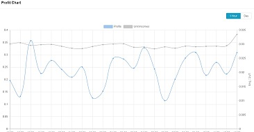

Ive noticed very much the same thing with my ckb AND kadena. a marked drop off in both which my inexperience is at a loss to explain. Im mining in dxpool and my star boxes and doge boxes are quite consistant but im noticing very erratic lines on the hashing graphs of kda and ckb.!
.does this look right to anyone
