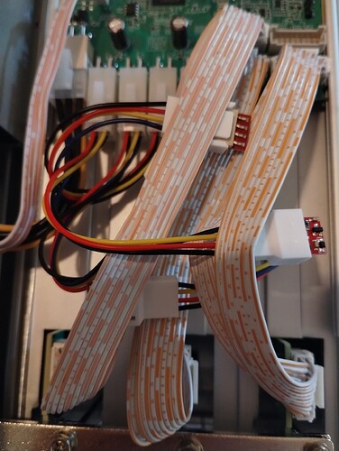

How do we plug in the fruition fan spoofers? The power cables cannot be directly plugged in because of the plastic covers over the female power cords. Do we cut the wires and feed them into the fan spoofer chip? Does the fan spoofers get broken down into 4 separate chips?
I’m not familiar with the newer control board models, but do those cables unplug directly from the control board? Surely they aren’t soldered to the board?
Looking at the photo right behind your finger I can see the female plugs, unplug those cables and try
As for the smaller fans, do you mean the fans in the PSU? I’m pretty sure they get unplugged and taken out too. If you go watch vosks video of him submerging you’ll see
Oh yep, the other models the board is a male from memory. Id be contacting fruition about that if they gave you spoofers based on that board model.
