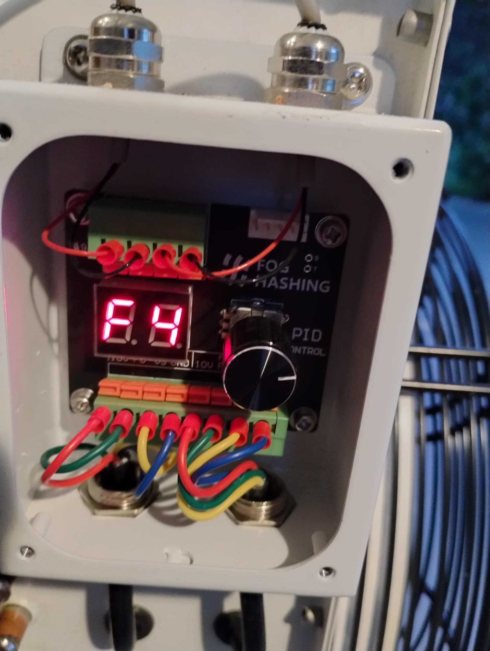

One of the fans is off and I’m getting a f4 code. contacted fog hash. Do you guys know what that code is or what the knob setting is for? Somewhere it says that normal operation setting, have the switch up, heating mode switch down. There are no switches. Just a knob
yeah you push the knob in and gives you 2 settings… 1. AC - Auto Control / FC - Manual Control and 2. The Temperature setting. FogHashing’s Support is really good. Especially if you use Telegram.

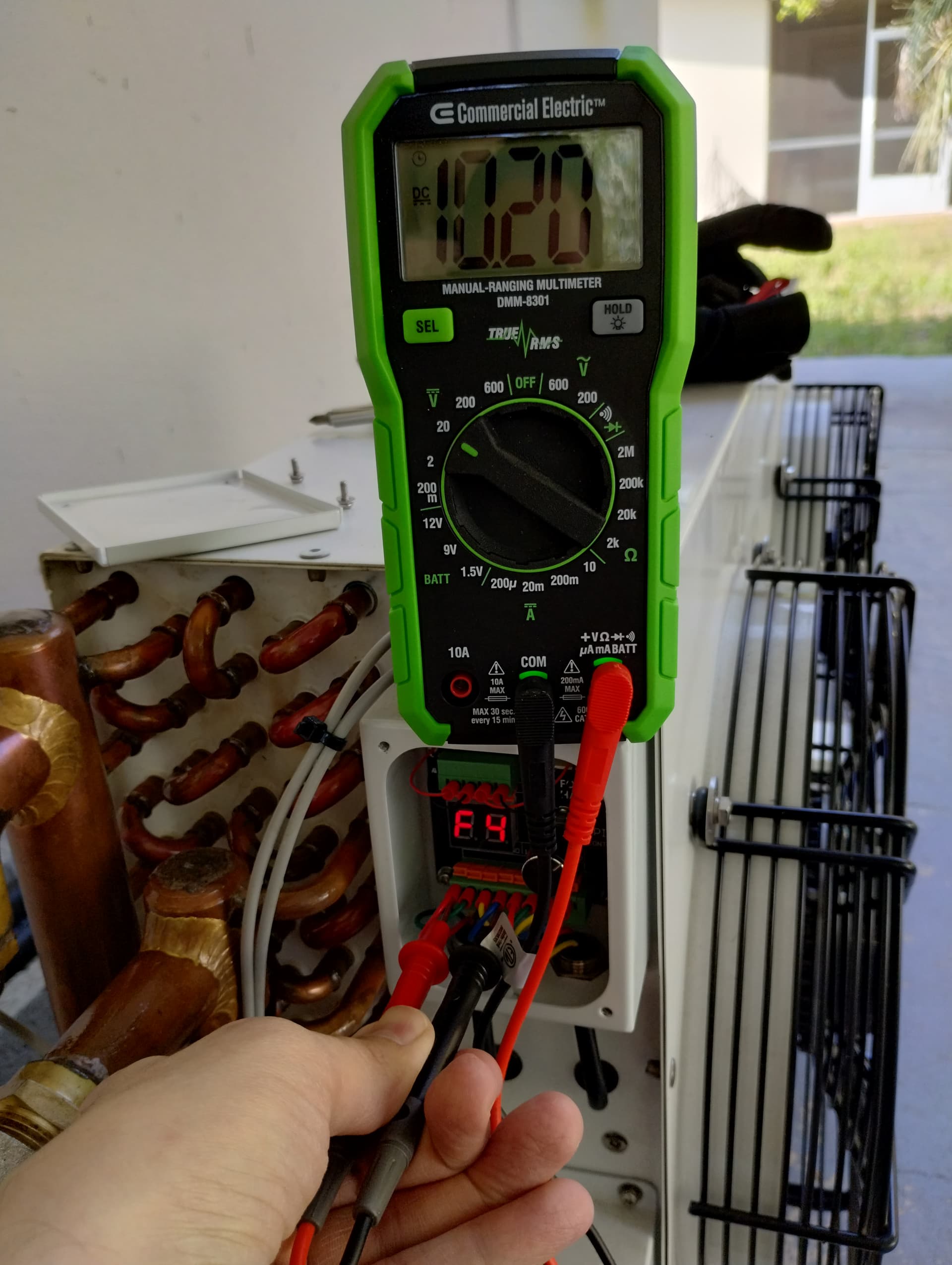

It’s been running around 51 degrees at night and 54 at day. I am in contact about troubleshooting the issues. The circuits are getting power and the instructions read as if I need to manipulate the wires when they are still getting current.
I’m waiting them to clarify about if the power is on or off when working with the wires.
