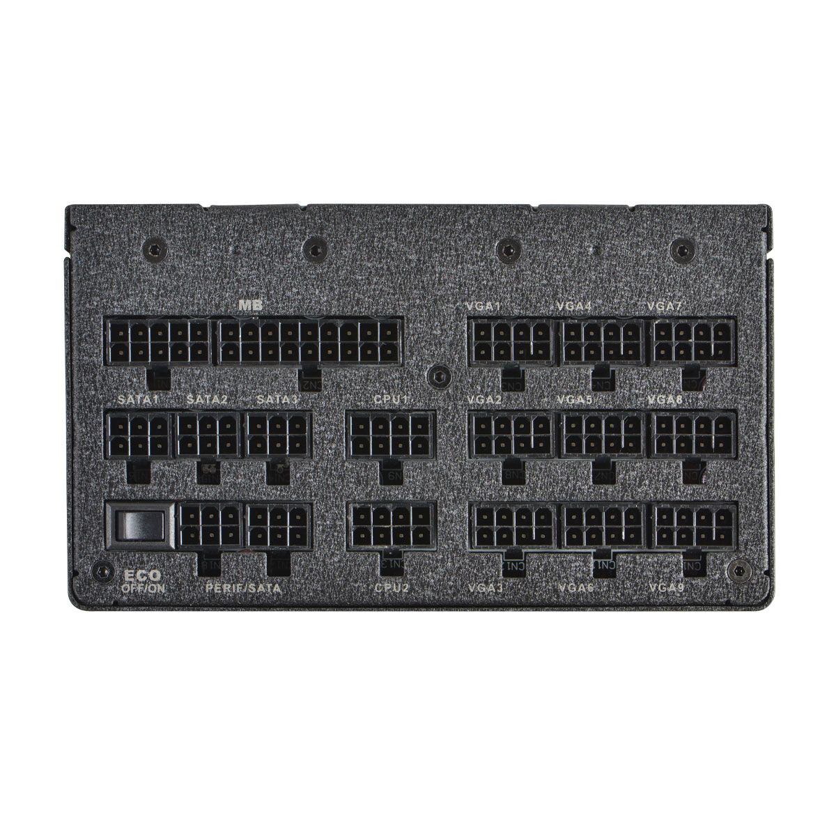

What is the safest way to power a 6-GPU RX 5700 rig with an EVGA 1600 T2? My risers have 6-pin and molex connections. After powering the GPUs, hard drive and fans, I have three available 8-pin and three 6-pin SATA/Peripheral connections left open on the PSU. One option is to power three risers with periph cables using the molex connector and three risers with three 8-pin VGA cables using the 6-pin connector on the riser. Another option is to use three 8-pin x dual 6+2-pin VGA cables and power 2 risers with each cable using the 6-pin connector on the riser.
They are currently powered with the 6-pin x SATA adapters that come with the risers. They have been running fine for 8 or 9 months and aren’t warm but your photo made me paranoid. All my GPUs are capped at 130W in the bios.
Dual 8-pin connectors on 6 GPU’s use up your Pcie connectors fast.
Consider using 3 six-pin Peripheral jacks on the power supply with 3 12volt six-pin (Bumble Bee) splitters to power the risers.
Use six 8-pin x dual 6+2-pin VGA cables (buy 8-pin to 8-pin splitters if your 8-pin cables are single 8-pin on the GPU end) to power the six GPU’s.
Many Risers also allow SATA or MOLEX power connectors in addition to the six pin peripheral power (the best).
Do not use two of these power supplies on the same circuit. Uh Uh, No way…Danger Danger…
