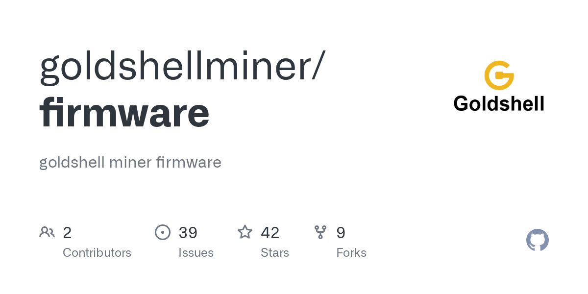

You can find it here.
I have 4 Mini-DOGE running for 30+ days on 2.1.2 with no problems or stopping.
you should down- or upgrade your minidoge away from 2.0.3.
either as per abobe link from @SUNYNKA or go to the official Goldshell side, there to suport, software, get the latest version … if you check the folders for will also find the archive.
dont interrupt the device while update is running.
you may have to search again for the IP after the upgrade.
@SUNYNKA, How do I select 2.0.2? This link only allows 2.1.3.
@JoeJoe, where can I find 2.1.2 version? Do I need to ask Goldshell support for this version or is it on the web and I haven’t found it yet?
2.1.2 is the version mine came with but looks like the latest is now 2.1.3. I’d install the latest if I were you unless that version is causing problems. If you really want 2.1.2 there’s an Archive folder at the top of the GitHub link @SUNYNKA posted above. You can download older versions there.
Is on this list, you have to search for it. It can also be done on the previous link I posted, but you can find it here.
