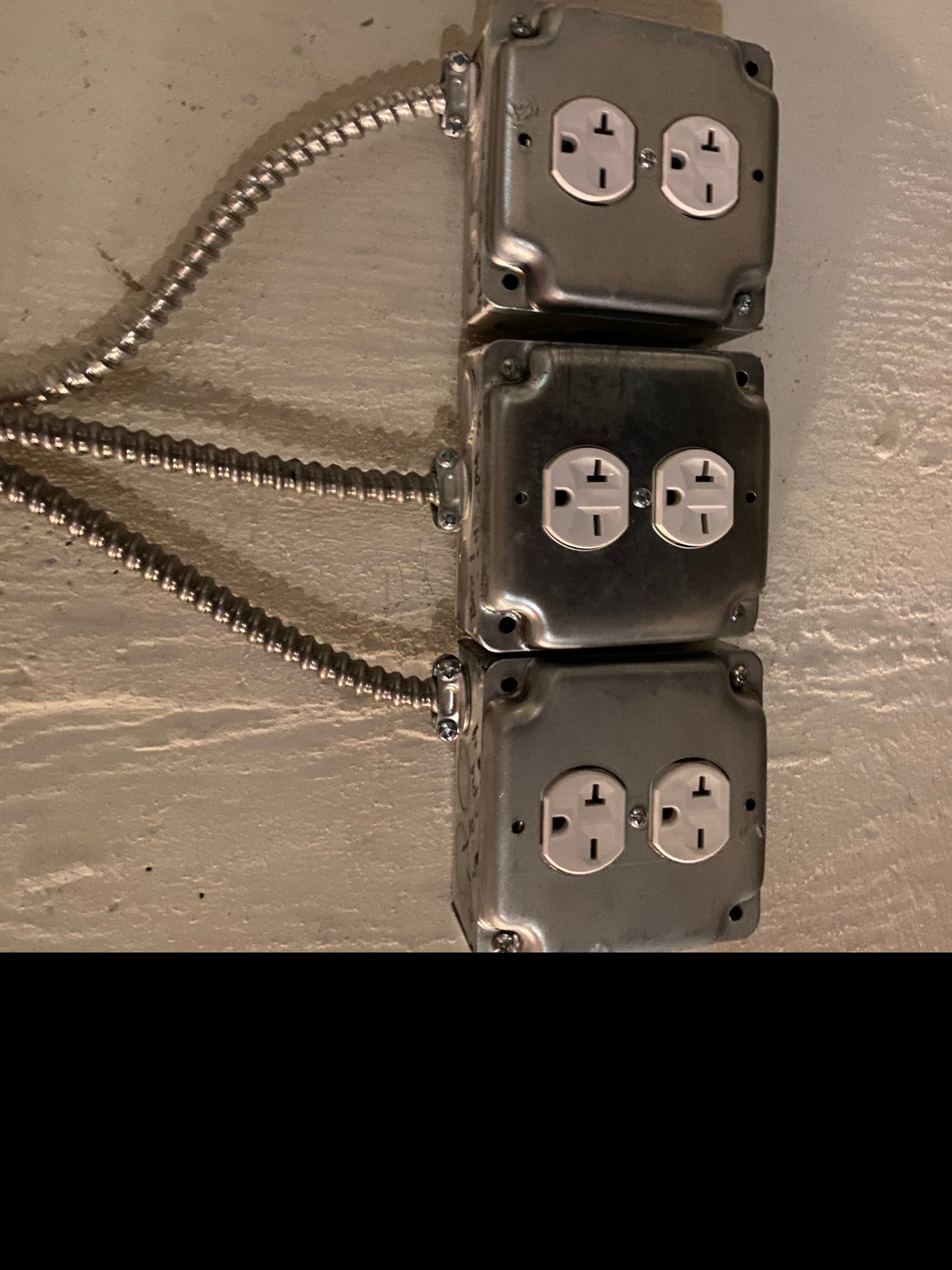

You can run it in a single 20 amp breaker, you just need the dual plug for 220-240V. Use 2 good wires. Don’t cheap out. I use 14 awg or lower. If it were a Goldshell, I’d use 10-12 awg as it’s a single load with one wire.
Awesome thanks Rob. I’ll talk to my electrician

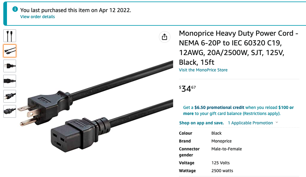

No, the inputs to the miner are different
You need the same plug with a C13/C14 male for the miners
That’s expensive, let me send you a link!!
Awesome thanks! Was able to find some from a canadian company, shipping should be quicker/cheaper for anyone else wondering.
Thanks for the link!! That’s definitely going in my favorites. That’s a good price!!
Great price. These cords can be tricky with so many variations available, even the first Bolon cord I ordered ended up having the opposite prongs, straight end was on the “left” horizontal prong was on the “right”. Had to return and re-order opposite prongs. Worth double checking before ordering lol
