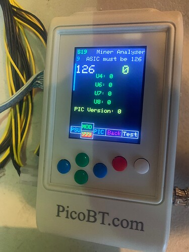

Was having issues with a board on my S19 90th that I copied the 104th J pro Eeprom onto. Kept reading zero chips. Plugged it into my PicoBT and ran some tests - still read zero asic chips. I then took the big heat sinks off on the back to see if I could find the break in the chain using the RX signal points - ran the test mode that tests the hashboard 999 times continuously so I could find the break and it magically read 126 asic chips found. I let it run 30 times and everytime it found all chips. I then put the big heat sinks back on and started the miner back up and it all worked fine. Not sure why that worked after but Iβll take it! Iβll ask my Zeus btc teacher why and hopefully he will be able to answer
For anyone curious he said heat might have been trapped between the chip and the heat sink and taking it off might have released the heat enough for it to function properly

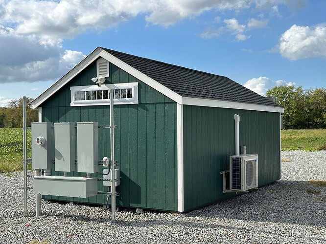

VoskCoin HDD mining shed
The grey shed on the VoskCoin mining farm, previously referred to as the 2.0 or 3.0 crypto mining shed is evolving simply into the VoskCoin immersion mining shed!
